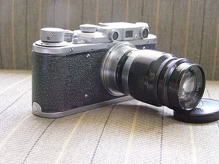

Looks good Spyderman, really good. What a difference from the original pic shared. Here's a quick shot of an Elmar.9cm on a Zorki. I remember being pleasantly surprised at the compact size when the Elmar arrived. I'm sharing because your photo has just revealed to me the size difference of the J.9.
Hey, get some shots and enjoy that Zorki!
