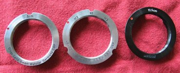

I have never had infinity lock issues with adapters per se. But other users should be aware that I have had infinity lock issues with some older lenses on a more modern M body. Specifically I have found that on some lenses the infinity lock can foul the frame selector lever on my M4P. This is most problematic with a 35mm f3.5 Summaron. (This is the early bayonet mount Summaron designed for use with the M3 and a separate shoe mounted finder.) I suspect other wide angle lenses with a focus lock may have the same issue (The problem is the height of the focus lock above the base of the lens - there is just not enough clearance for it to swing over the top of the level.)
Here's a photo of three Leitz adapters I have... Only the left one with cut out area works on my 35mm Summaron and allows infinity focus.
If you're handy with tools, modification should be easy.
Glenn
Glenn
Thanks, that makes it quite clear.
It looks like I won't need to do any modification as I've found a Leitz IRZOO in the UK for £22. Leitz's 5 letter codes make it surprisingly easy to find stuff sometimes.
