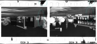

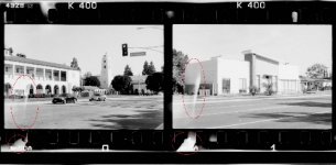

My M4-P has developed an odd light leak.
- It's intermittent, sometimes occurring on adjacent frames, sometimes not at all. For example, the first time it appeared, the leak affected three adjacent frames, 7 8 9, then nothing else on that roll. On the next roll I shot, frame 2 only. The next two rolls, no leaks. Next two rolls, on about 50% of the shots.
- When it does occur, it's always in the same location, but to varying degrees; sometimes faint, sometimes affecting much of the frame along a vertical axis.
- The leak in the image area is always accompanied by a distinctive pattern in the film rebate. Based on location, it appears that the leak is in the upper right of the film aperture, viewed from the back. As in the attached photos, I marked a strip of film and laid it in the camera as it would normally be exposed. The pattern in the rebate always occurs between perfs 1 and 2, counted from the right side, when the film is oriented as exposed.
I've run the common tests for this type of leak - covering the small RF window (tests the light baffle below the window); covering the back and hinge areas; and taping off all of the top, then selectively uncovering sections - but the leak occurs regardless. The shutter curtains appear OK, at least to my untrained eye. That the leak affects the rebate are seems to imply that the leak is coming from the back of the camera but, as noted, taping off the back didn't resolve the leak.
Any thoughts on other places to look, tests to run, or anyone with prior, similar experience who can comment on possible causes, are greatly appreciated. Thanks, all.

It is cutting across the sprocket line, not just the image area.
To me that rules out the lens or shutter.

This information alone informs me that the light leaks are most likely occurring while changing lenses in bright light. There is no way I am aware of where light can get through from the back door in this manner. If the light is bright enough is can reach the sprocket holes from the lens chamber side.
One thought I had was an eyelet for the neck strap, but that would move across the frame as the film built up on the take-up spool, and would also affect other frames in the wind sometimes causing two light strikes as it shines through the film. But it really looks like a back door issue since it happens in the same place. Both edges of the film are getting struck, plus there is the arc. Looking at mine, I would say it happens at the left side of the door as viewed from the back of the camera, so the film is getting struck before it enters the frame gate. You get varying degrees of strike depending on how much time lapses between windings, plus where and how much pressure you exert on the back of the camera when you grip it.

I hadn't considered that, but laid a bit of film in the chamber and the leak area also lines up on the left side, just past the cassette. I'll run another test with the back taped off, after the test process "monopix" suggested.
I agree this looks likely to be a leak into the film chamber itself rather than through the lens or shutter due to it affecting off frame areas.
Take a roll and load it into the camera (ideally in a dark area). Take a bright light source such as a torch (US: Flashlight) and systematically shine it through specific points on the camera in the areas identified as suspect; rolling the film on two frames between each test point. Log each frame (or more specifically off-frame) against where the light was directed. Hopefully you would have a roll where one or two off-frames would have fogging and the rest not and would know exactly where the leak was, based upon the log.

As farlymac theorized/suggested, you have a loose strap lug. It would be on the take-up side. The light streak lines up too perfectly.

Sounds like it's time to give serious consideration to the possibility of a leak around the strap lug. Maybe you could try firing a flash, or directing the beam of a flashlight, around the strap lug at various angles.
