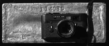

Thought you might enjoy this old shot of M5 resting on a bar of the stuff film is made from......... Too bad I couldn't slip that bar in my camera bag, unfortunately it weighed close to 80 lbs....<img>
