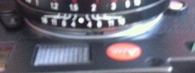

Stephen G
Well it would appear to be the adapter.
Focus tested it with the adapter off my 15/4.5 and looked much better.
Now-
Notice how differently the lens mounts on camera between my two adapters. Looks like its overrotating into the bad adapter.
Filenames indicate which is which
Now-
ampguy
interesting
interesting
which adapter worked well, and which didn't?
interesting
Now-
Filenames indicate which is which![]()
Stephen G
The bad adapter was a type-1 50/75 voigtlander adapter. It was old, used, came with the lens. Showed a bit of wear on the writing, maybe been mounted & dismounted often.
The good adapter was a type-2 28/90 voigtlander adapter, bought new about 2 months ago.
