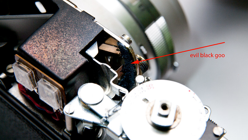

Well I seem to have worked out what the problem is!
Trying to tackle some of the other issues on the camera I removed the top housing to clear the dust out of the VF, uppon putting the camera back together the light meter wasn't working, the needle was stuck at 5.5 EV. Lots of research later and it turned out that a foam pad had disintegrated and was sticking the EV hold in place so I removed the pad with a craft knife and alcohol. The meter now works again and as it happens the meter coupling to the lens is controlled by a rod the other side of the foam pad so was also sticking.
Picture not mine, borrowed from https://www.flickr.com/groups/52109366@N00/discuss/72157623568134875/
