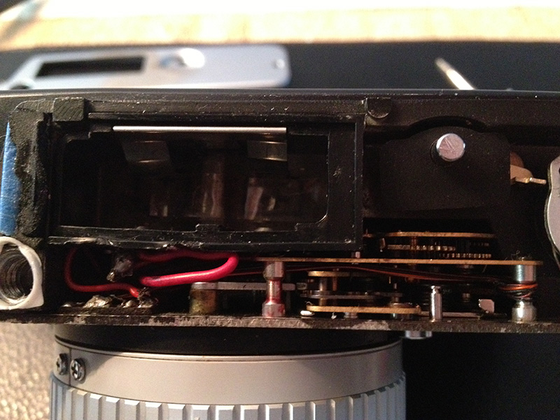

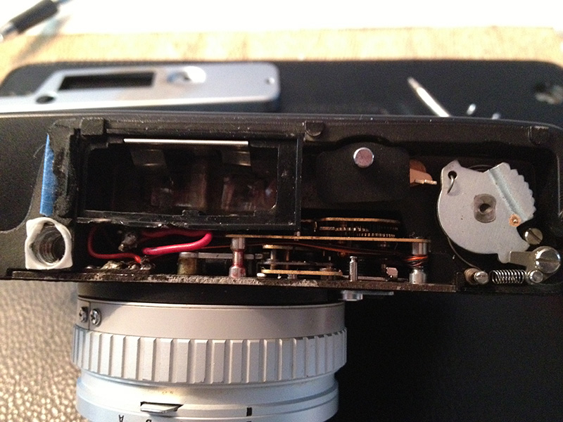

I'm new to film cameras so trying to get as much info and help as I can so yeah if someone can help me fix my problem, why not. I don't fix cameras and never have so wouldn't even know where to begin. Thank you for some of the ideas you mentioned. I want to try and get it fixed. Looks like someone on another forum mentioned that wires get corroded and need to be re welded or replaced. I tried a brand new set of batteries (SR44) and it worked for a day and now shutter doesn't even work anymore.
I have no idea what I need to weld looking at the inside:
Jeez, could you post those pictures a little larger, so everyone would need a 72 inch monitor to see them? Please downsize them (800x600 is fine).
