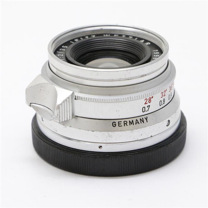

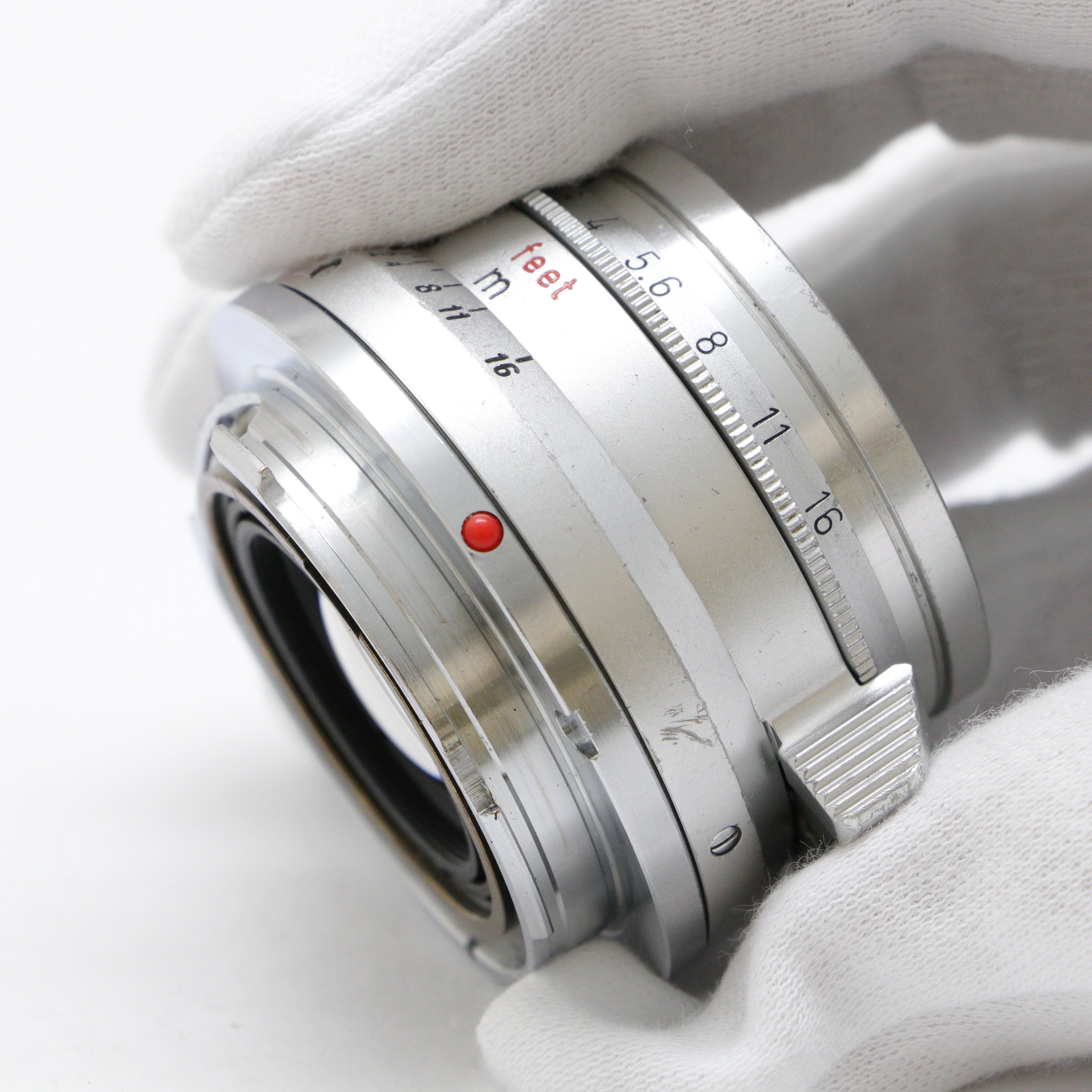

Many people aren't aware of these special Summarons/Summicrons, so look closely at photos on auction listings, or ask the seller for additional pics that might reveal the set screw (encircled in blue in one of the earlier pics.)
Yes, I see the set screw, but it is a strange lens in my opinion. The weight is 140g, my 8 elements weights 180g. I've never seen or heard about a Summicron that focuses to 0.7m in screw mount (normal is 1m), so I guess it is a special lens, perhaps made on special order.
It can also be originally a goggled lens that got this mount by someone. The goggled Summicrons focus to 0.7m (the goggled Summarons to 0.65m).
Erik.
The screw in this photo is NOT the set screw for the bayonet. I don't think this lens is a convertible; it's an M bayonet only. That's why the red dot is on the bayonet.
The set screw for convertible lenses is much smaller, here it is encircled in blue:
I have had 2 or 3 of the convertible Summicrons that focus to 0.7m, one of them being pictured above.
