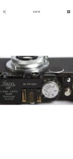

Hello esteemed RFers,
I am interested to pick up another screw mount Leica. I have consistently gone back to screw mounts whenever I've strayed to other cameras. Most recently, I bought a Leica M4-2 but still am pulled back to the older bodies (maybe like my own...).
Anyway, I've been offered a black paint Leica ii (my favourite), which has no slow speeds (but the circle on the front where they should be) and strap lugs - two ticks in the box there for me.
However, the shutter speed dial has 1/1000 and it also has the flash sync added. Clearly the camera has been modified but all appears in good shape.
My question really is: does having the 1/1000 add any sort of fallibility into the ownership of these old, old beauties? Does having the flash mechanism mean there could be issues where a simple 1/500 plain old Leica ii would not experience anything negative?
For info, I'm not sure I'd use the 1/1000 speed but the camera looks very nice and is a reasonable price.
Thanks!
In itself the addition of flash sync doesn't matter, but it does matter who did it and how well they did the work. A CLA by a trusted repair shop will reveal the true condition of the camera. But any camera of this age really should get a CLA before it is used again.

Thanks for replies. It certainly looks like a pro finish but what’s under the hood, as it were, is unknown. Serial number is 191503. I have already looked up the number. It was really a question whether, in your opinions, adding in the additional speed causes unnecessary problems given that these cameras are generally amazing because of their simplicity.

If the flash plug is on the back next to the finder window and the speed dial looks like a IIIf dial with the flash value numbers around the outside then it is most likely to be a factory conversion.
The 1/1000 on ltm cameras can be wishful thinking but I doubt it will have any effect on anything else.
It is better to have a conversion - preferable a III - without the flash synch: 1. it looks better 2. the synch can (and will) cause problems with the high speeds (uneven exposure).
It is better to avoid the conversions altogether. The originals look much better and are very reliable cameras, above all the III.

This is helpful, thank you. I have had a standard, a iii a ii and an M4-2. Personally, the iii was the best of the bunch (I do love screw mounts!). I’m tempted by this one as it seems a fair price and has the strap lugs. I’m not a big user of the slow speeds but what you say about the issues with speed as a result of the conversion has be slightly cautious. Also, I notice this doesn’t have the - under the o of ‘No’. I’m still tempted though...!

Your III is nice, black paint with paint-filled engravings.
Personally I do not like the synch conversions. Conversions without the synch do exist, however.
