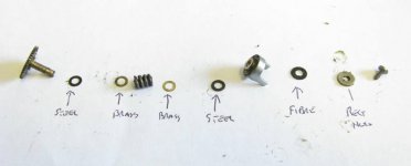

Hi all, re the Kiev take-up spool yoke etc, whilst I was in the mood took another image of the parts layout/order of the assembly.
I lost the sequence of the one I imaged for the previous post so was in a real mess !. Had to disassemble onother spare I had to put the demo one back together ! bugger !.. anyway I photographed the damn thing this time so maybe some help to another poor Kievaholic, here is ----

This pic brings to my mind two comments, which may be of importance in case you have followed my posts at the thread opened by SCOTFORTHLAND on the Kiev Frame Spacing issue
http://www.rangefinderforum.com/forums/showthread.php?t=65607
a) from the fork outwards there is no washer beyond the disk with its rectangular center. Any way, even if you want it, you will have no free space for another washer if the disk is to catch the rectangular end of the shaft.
b) as for the accurate order of washers and spring, I don't give it much importance if you make the whole compound work. But here there is a highly important precondition to remember when you are battling to insert the screw: The upper teeth flat head of the shaft must match the other gears up there in its neighbourhood. You do not see them unless you open and disassemble the top casting.
From here another implication flows:
b1) If your camera is in no need of a general CLA, but to clean and reassemble the take up fork (you may have inherited a misadjusted disk - this is the case when a ridiculous irregularity takes place) then you can just disassemble the top casting to overview the fork and shaft harmony with the other gears pushing the take up fork. And with a dissasembled top casting you will be able to insert a finger or a tool to maintain the shaft in place while you press with the screw.
Finally a required word about common sense. We have digged here quite deep concerning the frame spacing issue. I do not expect a perfect frame spacing from this mechanism, not for being a Kiev instead of a Contax, but because of its basic design. I don't expect it to match a simple rangefinder from the sixties and onwards. But insofar as the open spaces at the begining are not too wide and the close spaces at the end of the film don't begin to overlap, and both patterns are consistent from film to film, I will not disassemble the fork compound but just adjust a little bit the screw, either to the right or the left, and see the results.
A consistent frame spacing irregularity pattern from film to film, provided all other factors mentioned in the above quoted thread are given, indicates that the disk is in place. This is just my attitude. You can try yours and don't take me for granted.
