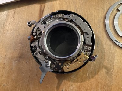

This Moskva shutter has been in pieces on my desk for months. I just cannot get the damn thing to stay cocked - the black catch lever isn't able to keep the mechanism in place once the shutter is cocked.
Here's the shutter at rest:
Everything runs perfectly and the timing is good, it just won't stay cocked. Here's how it looks when the shutter is cocked:
That black catch lever sits into a notch to hold the shutter primed until the shutter release pushes it out of the way - but as you can see, it fits very loosely right now.
I have absolutely no idea how to solve this. The spring wire on the catch isn't replaceable, and I'm not even sure that's the issue anyway. It's driving me nuts trying to figure out a fix; I'm half-tempted to use a Dremel to reshape the catch lever slightly so it can sit in there tighter, but that seems drastic (and, of course, is irreversible).
Any suggestions?

I've considered that. They do seem to slip apart a bit too easily. My thought with the Dremel was to take off some of the "meat" opposite the pawl on one of the components so there's more space for the two parts to mesh together - if you look at the second photo, it seems almost like there's not enough room for the catch lever to lock in properly.

It kinda looks like the entire tip was rotated counter-clockwise a bit. The shape is not ideal, for sure.
If I were to start somewhere I'd file off material from the back side of the catch pawl/lever's tip. That would allow the tip to get into the notch a little better.
That's the point I'm thinking about - however upon sleeping on it, that curve of the catch allows it to slide into place. I'm more inclined to file away the corresponding point it makes contact with on the shutter cocking ring so that it has more space to sit in there.

Again, I suspect "sharpening up" the locking surface on the cocking ring should be the first port of call. I don't really want to tinker too much with the catch itself if I can help it!

I had the very similar issue after dismantling the cocking ring and release lever and cleaning the shutter. But unfortunately I cannot 100% surely remember in detail which was the dislocated spring causing the issue. Here’s however some tips on what I do remember. Look closely the black spring, that is close to the sync contact at the end of the long lever driven by the shutter release lever. It was either that or then there was a spring underneath those levers that spins around and jumps easily to a wrong position and then the claw does not go deep enough to the groove. Thus the shutter trips way too easily and in B position it will not keep cocked at all. If you get hold of Maizenbergs book there are diagrams how shutter should work and if you study how the shutter works in B position you can pretty easily see which spring was spun into wrong position. There’s only one or 2 that push that B-mechanism levers and the levers that keep the shutter properly cocked. You can cock the shutter covers dismantled while supporting the cocking ring time selection ring in place with fingers. Do not file anything, that’s probably not the issue.

As for 1/250: that still won't stay latched. The heavy spring that comes into play when 1/250 is selected is far too powerful, and the black catch pawl still isn't making a positive enough lock to withstand the spring. I suspect fixing whatever's causing the speed selector ring and the lever on the delay mechanism to not mate properly may help as tightly squeezing the whole unit where the catch pawl is located while priming the shutter seems to help, but I still can't shake the feeling that the actual mating surfaces of the catch mechanism might need refinishing slightly.
On the last picture you’ve posted it looks like that at least the small hinged catch/hook on the cocking ring is in wrong position (just barely visible on the lower left hand corner). But maybe you already put that in place. B not engaging, do you mean it just runs through, the catch does not catch the ring as it should. So the required levers do not move close enough towards the lens? I hate that I cannot any longer remember clearly how I managed to fix it, but I do remember that following that mechanism I found the issue. Somehow one of the levers had gone into wrong position so that it prevented the others moving freely far enough - all the way up to the black catch keeping the shutter cocked.
