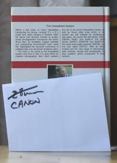

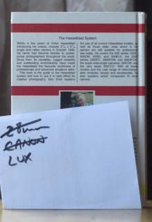

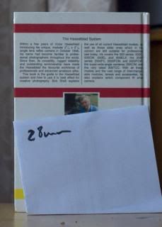

Just did a quick sharpness test on my M9 with my wides,
28mm summicron
35mm summilux pre asph (at F2)
35mm Canon F2 Ltm
And the sharpest yes you guessed it the Canon
28mm summicron
35mm Canon F2 Ltm

Would love to see the test shots.

I have the Summilux and the Canon lenses. The OOf rendering is also important.

did you focus bracket?
I would be surprised if the Canon was sharper than the 28 summicron. Can't speak to the pre-asph 35 lux, but the 28 cron has measurements that were simply impossible to achieve in the days when the Canon was designed and everything I've seen sample wise has confirmed that.
Fraser
Its a bit unfair for the 28 as it more of a crop and maybe not much in it between the cron and the Canon. I think probably the 28 is just a bit less contrasty and is smoother between tones (if you know what I mean). But what surprised me more was how good the canon was next to the summilux.
The only reason I bought the Canon was because it a good deal.
I maybe should bracket my focus maybe I was just luckier with the canon.
