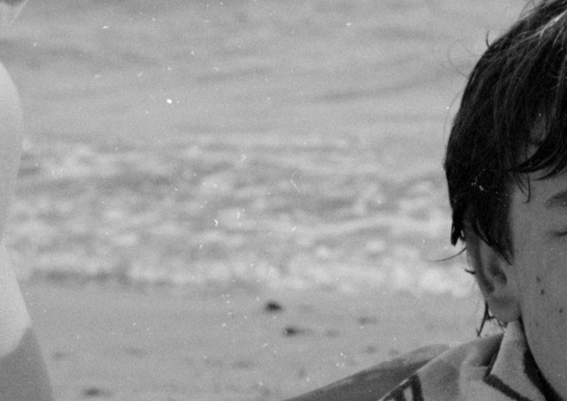

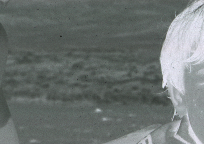

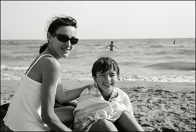

Here we go.
First, one of the rare pictures from those Acros rolls shot in 2009 for which I took some time to remove the spots with PhotoShop (what a bitch of a job).
Then, a 100% crop of the center of the image (negative then inverted) scanned a few minutes ago at 2820 dpi with a film scanner.
The spots looks like randomly located opaque crystals trapped into the emulsion. The whole frames of the whole Acros rolls shot back then were like this.
The negative is immaculate when looked at with the naked eye and even with an office lupe from an oblique angle. This had never happened to me with any other film and this never happened to me again. Only with all the Acros rolls developed in the same D76 1+1 I have been using for decades and which I am still using now with no problems with many other films.
