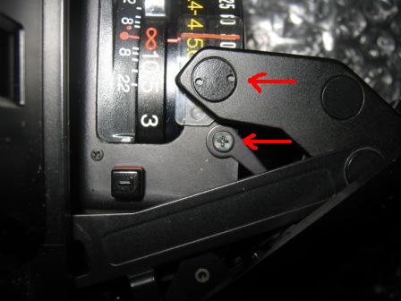

Basically the first four screws for the front standard can be removed with the camera closed, opening the rear door and you will be able to see them.
Next, you need to remove one screw at each side of the shutter assembly, where one post is linked (they are visible with the front door partially opened: since you removed the front screws, bellows will remain collapsed, or due to degradation they may be sticky and you will need to remove it gently).
When you remove those two screws (as said, one on each side) the shutter balances freely, but it is still locked in position by the two big-headed screws at each side which requires a double-pinned screw driver, or a spanner wrench (with pointed tips, that's what I use).
When those screws are removed, the shutter and lens assembly can be taken out of the way, but they are still linked by cables, so be careful and don't pull with too much force. Only 4 more screws are left, which can be accessed from inside the bellows.
Clean it very thoroughly before installing the new set of bellows. Then put everything back, and you're ready to go.

I like your spirit jnoir. OK, let's keep sharing information. The four screws from the inside were easy. Next, I think you mean these two screws (per side), right?
The Phillips head was easy but my available tools won't move the big one. Looks like a 4.5 or 5 mm Minispan wrench would be best but those are pricey... Looking at the SP1 from Micro-Tools, is that what you use?
Exactly so, you got it.
My spanner is the T-132 with 7-D tips for those big screws. Not sure if SP1 would work (it closes up to 12mm, and I don't know the distance between both little holes) but I prefer T-132 because it is more versatile. If you are going to do more camera repairs in the future, this set is pretty useful: http://www.micro-tools.com/store/P-T-132-346/Spanner-Wrench-Set-w-A-B-And-D-Blades.aspx
There are people who just use a Dremel to file a slotted tip wide enough to cover the distance, maybe that's a cheaper and faster option for you.
I think I'll take my Dremel but not to mutilate the screw (who knows, I may want to sell the camera at some point). Rather, I'll see if I can cut a screwdriver blade to match.
Sooner or later I will need a lens spanner, though. I have some lenses to work on, too. So thanks for the recommendation.
Ha! It worked. A 1/4 inch screwdriver ($1 for two at Wal-Mart) and 5 minutes with the Dremel and cutting disk made the right tool. Those screws had Loctite on them, by the way.
I found everything exactly as you said, jnoir. So, for the record, post #9 above is the gospel truth, folks. I took some pictures along the way which I'll post if there is interest.
The old bellows is out, leaving behind a mess of rotted foam that I'll attack another time. Do I need to build that foam back up?
Yeah, sorry, English not being my first language, sometimes my explanations are not clear enough... :bang: When I said "file a slotted tip", I meant what you did, take a screwdriver and file the blade. Whenever possible, drilling screws is not the recommended way to go, unless as a last resort.
This friend of mine I mentioned in an earlier post took the bellows because a couple of months ago he gave me the camera to replace the bellows, but those two screws could not be removed (don't know the english term, simply you can turn the screws all day and they won't come out at all...). Some previous repairman or owner did a bad job... and now the screws must be drilled to try to remove them.
About the foam, clean it thoroughly. I'd recommend you to replace that foam, but for comparison purposes I have replaced the bellows of one without replacing the foam, and after more than one year, it works exactly the same than it did with the old bellows and the foam, and exactly the same than others that I have repaired and included the foam.
