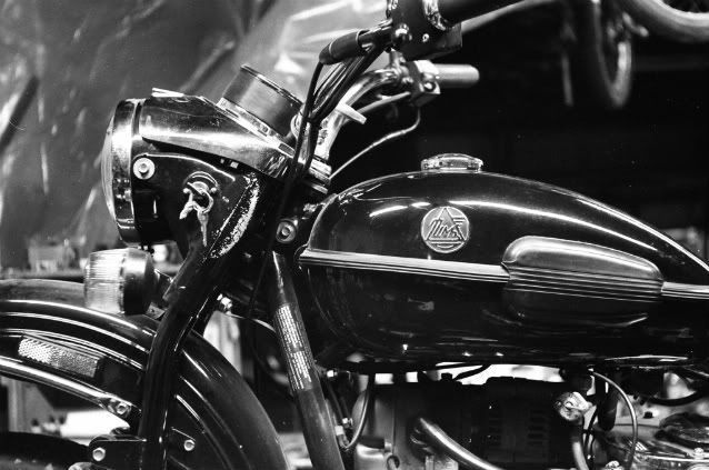

First, the good news. New Fed2b, w/ Industar 26. It's green! The rangefinder is nice and bright, seems to be right on. From the test roll: shooting a Ukrainian bike w/ a Ukrainian camera.

Congratulations on the FED, commiserations on the curtains and congratulations on the nice bike photo - what is it? Is it a sidecar outfit (I notice it has Earles forks)?

Thanks for the advice wolves. Not sure about the forks, but the bike is an old Ural currently in my friend's shop. The sidecar is going on his BMW for the winter. I'm gonna try fabric paint on the curtain first, but I have shutter cloth on order.

I rode a Cossack combination once, years ago - it terrified me for the lack of brakes! There wasn't much "go" but there was even less "stop". I really wouldn't want to ride one regularly without some better brakes.
