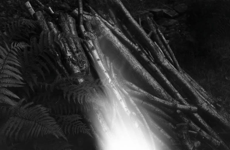

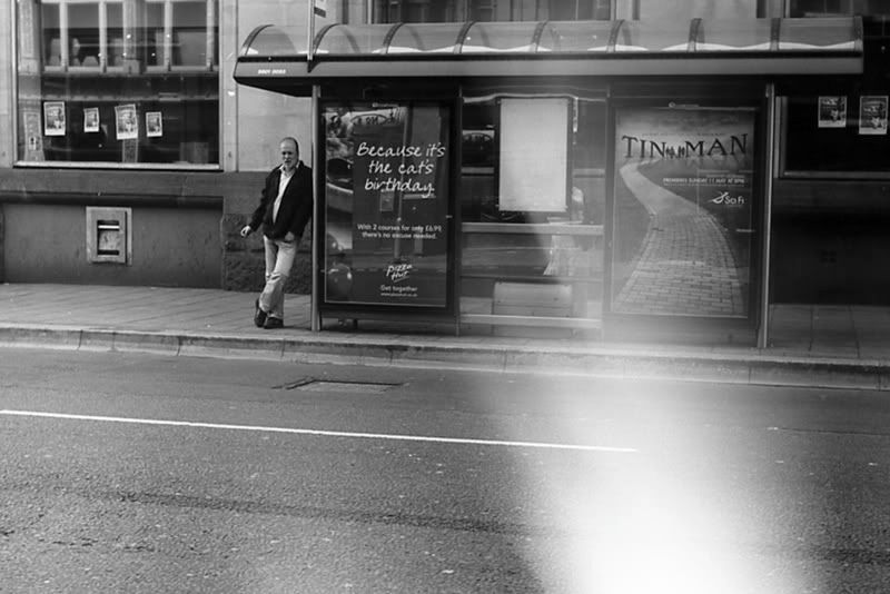

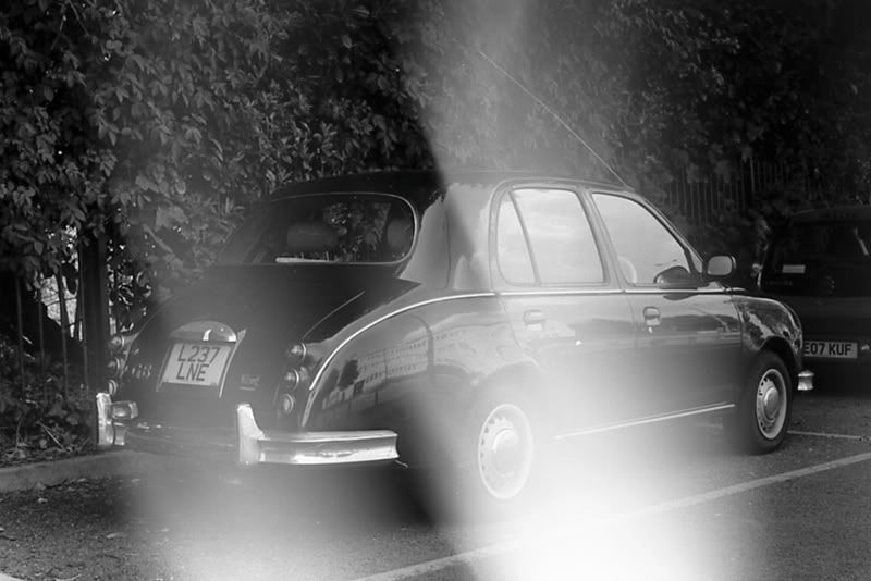

Anyway, i now have a scanner and this is the problem:
The examples make it a lot easier to know where the leak originates; the picture is formed reversed and upside down on the film, so the leak is near the top of the back of the camera. Perhaps it's indeed where this recess is near the back. You could put some black tape over it and do a test roll?
