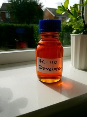

Split it in small air-tight bottles. My HC-110 is still working, no change in quality or in colour, after three years. The small bottle currently in use gets slightly darker in a few weeks but develops as expected..

That is what I have been doing. I still have a 250ml bottle in my cupboard. Knowing my developing rate, this will last me for more than 2 years.

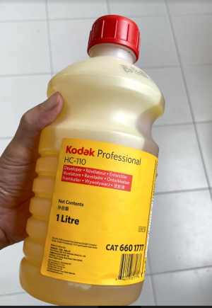

Hello Pan,
Not sure if this info. is helpful but it is my personal experience with the new Kodak HC-110.
I bought this bottle of Kodak HC-110 produced by Sino Promise (Wuxi, China) which has an expiry date of 2024-01. I have been using it for about 10 months now without any special storage (no dark small bottles, no fridge, and mind you Singapore's average temperature is about 33 degree C). It has been working just fine so far. After 10 months, it seems to be as potent as new. No crystals formed.
As I bought it online from a Taiwanese reseller, its price is not much cheaper compared to Ilford ILFOTEC HC. So I intend to switch to ILFOTEC HC once this bottle of HC-110 is completely used up. (I only used about 400ml of it so far.)

My take: if you use this stuff sparingly, might as well just get an Ilfotec HC and be happy.

The most important thing for storage of developers is good bottles/storage containers. Pan, you already have that under control - a borosilicate bottle with an impermeable sealing lid. The gas to fill the airspace isn't a bad idea but it will leak out over time anyway.
