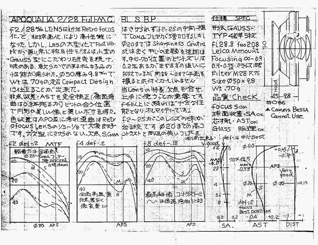

Mr. Miyazaki just introduced an Apoqualia-G 28/2 for 97,200 yen.
The lens is 9.8mm thick and weighs at a petite 70 grams. It's a 5/4 Gauss type (the diagram shows 6 elements though) that's designed to be soft wide open and sharp from f/4 onward. Highly corrected for astigmatism, with minimal distortion.
As usual it's not perfect but look at the size...:bang:

Does anyone know why you can't use it on a Bessa?
The rear element might be protruding too much - half the optical assembly is behind the flange.
The MTF is typical for a wide angle Gaussian lens. It should have similar performance to the 35 Summicron v3 or more optimistically, the Contax G Planar 35/2, with adequate sharpness.
No one had pushed the 28mm Gauss type design this far since the 1950's, so the lens is unique. Unlike the Apoqualia 35/1.4, this one has no obvious substitute - that's the point people might be buying into.

The 35/1.4 Apoqualia has the same Gauss design and very similar MTF curves.
I imagine the images will look similar - just a bit wider view and a bit broader dof.
