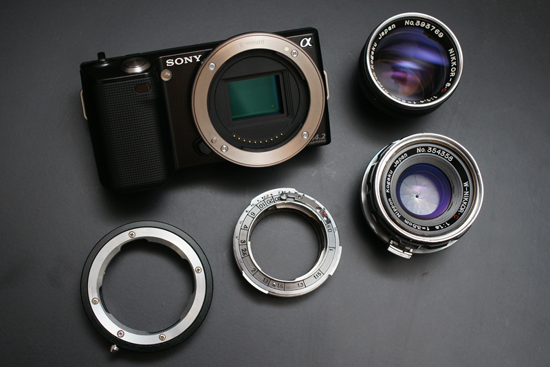

Hi Arturo, There are 2 ways to use your Nikon RF lenses on an NEX.
If you want to use External and Internal mount lenses both, you need two adapters, 'Contax - M' and 'M - NEX'. Please see the below picture.
11142D2F4C9C462A0EB0EE
But If you need External mount lenses only, You can easily get the SC E-adaptor from Cameraquest. : )
