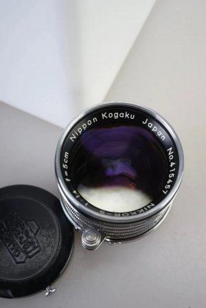

Hello everyone, just wondering if the collective knowledge here can help me. I’ve just purchased a Nikkor 5cm/1.4 LTM lens, black belt version. I’ve now realised that the name ring marks it as Nikkor-S only, rather than S.C. Does anyone know if this makes it any different or did they just drop the C on later production runs? I know in S mount the S only version was the Olympic and different design but to my knowledge that was never released in LTM. Is there any way of dating the serial number too? Thanks all! IMG_8352.jpeg

Nikon dropped the C (denoting a coated lens) in late 1958 or early 1959 for S-mount lenses, starting with approximately serial number 3960000. Info found on page 106 of Nikon Rangefinder Camera by Robert Rotoloni. While the book only discusses the S-mount lenses, it seems reasonable to make the same assumption with regard to LTM lenses.
Yours is a very late one in LTM.
Nikon changed the optical formula of the Sonnar type 5cm F1.4 throughout the run, yours is probably the latest.
These changes are undocumented as far as I've seen. Some of the differences can be measured, discovered taking apart my 5005 series 5cm F1.4 lens and measuring diameter of the optics and fixture, compare to later ones.
Brilliant, thanks for your help!
I put one too many zeroes in the serial number, should be 396000. Damn astigmatism!
