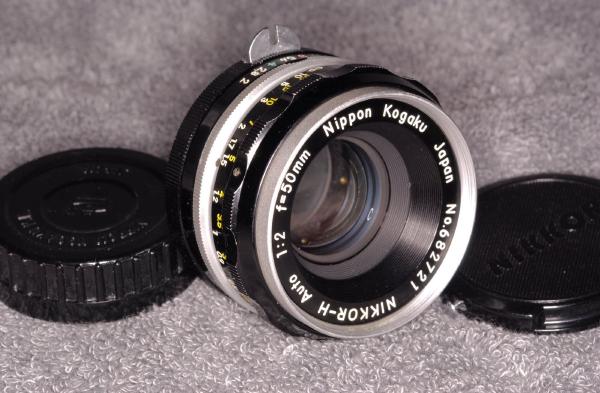

This is the 50mm F1.4 lens that was current when the Nikon F Photomic T was out, which is the same vintage as the Nikkormat FT:
attachment.php
"Nippon Kogaku" instead of "Nikon", change-over made ~1967, and a "V" shaped meter coupling ridge. Later changed to a curved shape. The V shape is "not optimal" for a Photomic head, but is fine for a Nikkormat.

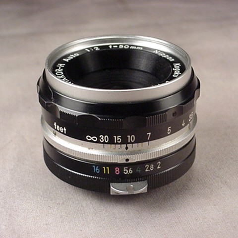

attachment.php
A 5.8cm F1.4 preceded the 50/1.4 by a couple of years. Not made in "BIG" numbers, but plenty of them around when the FS was introduced. Very different optical formula than the 50mm F1.4 lens. Closer to a Leica Summarit.
