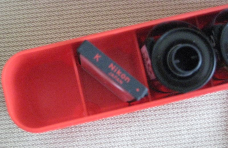

Excuse the poor quality snap, but you should be able to see the following all in red...
K Nikon / Japan *
More important is the lip on one long side of the frame - that is the main distinction between F/F2 and F3 screen frames. Some original F screens also had red inscriptions, and dots might be later additions by some user. And F screens will fit into the F3 - but as they use a different mechanism they don't lock into place, so they might be misplaced.

No red dot on mine.
Nothing else seems wrong with the camera. Everything works except the viewfinder illumination light/switch. It's all in fantastic condition, except for that weird cloudy stuff within the screen itself. I'll try to photograph that tomorrow. The screen has a convex side on top - that surprised me - and the matte surface on the other side. There is a lip on the long side.
