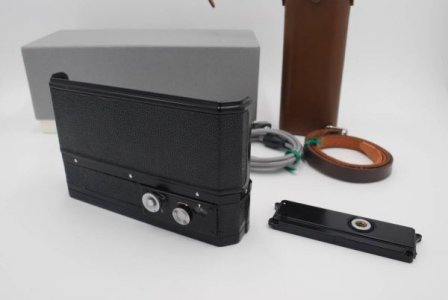

Hello,
please someone may inform me about the possibility to fit the classic Nikon S3 Motor Drive to a modern replica Nikon S3 Millenium (2000 year)?
I found a mint S3 Motor in Japan and I have to mate this one to a Nikon S3: vintage or replica?
Thank you for kind help to all!

Thanks to all!
Actually the S36 plate adapter is included in the kit I just ordered.
Please see the pictures, it seems an original S36!
It's the replica version. I have seen similar copies here in Japan. But don't worry, I also have the replica motor attached to original S3 camera and can shoot with it without a problem. In fact I use replica motor when I go out shooting using the motordrive. The motor is repurposed from F-36 (which runs on 12V) and the battery pack you have takes 1.5v x 6 batteries =9V but still works fine.
As wes loder commented above, you may need to play around with the 2 screws on the connecting rods that is moved by toggle arm on the motor plate to ensure the see-saw motion works smoothly when you fire. I have adjusted mine with some trial and error.
"As wes loder commented above, you may need to play around with the 2 screws on the connecting rods that is moved by toggle arm on the motor plate to ensure the see-saw motion works smoothly when you fire. I have adjusted mine with some trial and error."
Start with them short. I recall that the one to the middle of the plate is adjusted first; lengthen until the shutter fires. Then lengthen the inner one until the motor fires and winds. The kit should have some tiny shims / washers that go under the screw when the position is determined. The shims let one tighten the screw so that it will not move.
