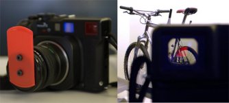

Actually, I'd be suprized if no-one has ever done this, but I'm so excited about this I wanted to share it with you guys...
After a few prototypes I've arrived at a foolproof solution for remembering that the lens cap is STILL on the front of the camera.
Originally I just bolted a red piece of plastic on the lens cap that could be seen through the main viewfinder, but I get so excited and focused (no pun intended) on the subject matter that it still wasn't enough.:bang:
I had to find a way to disable the camera. I realized that if I blocked the focusing portion of the viewfinder with the red plastic, the camera can't focus!(DUH) An unintended effect which is really cool is that the red plastic leaves a red square when you look through the viewfinder. And if I'm still too excited about a particular photo op, the camera not focusing is always enough to make me stop and remember the lens cap is still on.
Yes, I know it looks silly, but I promise you, IT WORKS. When I find just the right material, (ideally a sandwich of black and red plastic so that it doesn't look so obnoxious from the front of the camera) I'm going to make one for my Polaroid 600 SE and even my Yashica Electro GX
hoping this message finds you well -Ian

Yeah, you're right. Unfortunately I'm a tad paranoid and messy. I always seem to get crud or dust on my UV filter and I end up having to check & clean it every time I shoot.
I picked the red plastic penut butter lid out of the recycling bin and the screws were 25 cents a piece. Total cost 50 cents & 15 minutes with a drill (cut & pre-drill plastic lid & lens cap) and an allen wrench, which means more $ for developing film 🙂

I taped a plastic spoon handle but I had it angled so it was visible in the vf, rather than coloring the patch.

for most of my lenses, I simply use a snap-cap that has a small protrusion on it to attach a cap-keeper; I always try to remember to orient it so that the protrusion is in the viewfinder

How did you drill the holes in the lens glass for those screws?

Oh, I wouldn't dare drill holes into the lens glass! Sorry if my explanation was confusing. All I did was drill holes in the lens cap using a cordless drill, making sure to drill holes that were of a slightly smaller diameter than the screw threads so they would have some plastic to hold onto.
