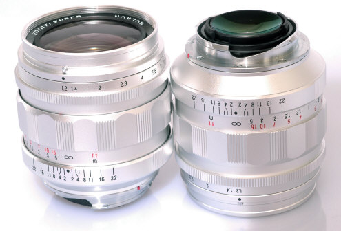

There's a rear element guard on the lens that fouls something in the M8, needs replacing. The guard looks like this: ( ) (i.e. gap top and bottom around the rear element. On an unmodified lens this rear element guard protrudes a fair way:
Yes, focussing to infinity on older Noktons bumped on the inside of the M8. Camerquest states they will have them 'refitted' for free if you send it in.

So I need clarification - the Nokton shown here, is it modified or not? I assume not because I don't see "M8" in your signature, so I assume you have no need to modify it.
To add to my question: I have a Nokton, but mine is almost flush with the rear element - I would say they protrude no more than 2mm, max.

So I found this image of a chrome Nokton on CameraQuest's site. They were just released. I just bought my (regular/black) Nokton from B&H in NY a few weeks ago. My Nokton's rear-end looks exactly like this:
Can I assume I'm good-to-go to put it on my M8?
Ok, I think I get it. I see how the two "ears" on this lens are "stepped" whereas the lens shown above has two rather solid bits.
Mine is stepped, thus ok on my M8.... I think.
