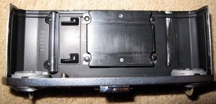

Popped into my local junk shop today as I spotted a camera from the door... Next to a Nikon SLR I couldn't ID without reading specs was a brown leather Zeiss-Ikon case, so I opened it up... and swore! The chap in the shop said he knew nothing about cameras, he was going to put £50 on it, so I thought *Sod it* and paid.
So... looking at the intertubes I *think* I have a Contax III. Body number is B59218, the lens is a collapsible Carl-Zeiss Jena f2 Sonnar Nr.1827262 - a little oil on the aperture blades, and maybe some haze, but I don't think any fungus (famous last words). It's also obviously got a bit damp at some point as the brassing on the back is knee-deep in verdigris, but I've seen worse.
The shutter doesn't work - which is a drag, but maybe one day I'll have time/money to sort it?
Quality of pictures and lack of hardcore research down to me doing this (and buying it!) when taking a break from strenous DIY!

Yes, a Contax III. The lens alone is worth what you paid if it is in decent condition. B serial number means camera was likely produced in 1936, ahead of the introduction of the Contax II and III at Photokina show in March 1936. The lens is part of a batch of 2000 completed in February 1936. According to "On the Trail of the Contax, Volume 1
Blimey - and in a junk shop, too. Rats - too late for a lottery ticket this evening! Thank you - that's made my day.
The verdigris is more likely the result of the camera being stored in the case for so long that as the leather soaked up moisture the tannins ate away at the chrome. Pretty common to find on any old camera that hasn't been used for many years. Dried lubricants may be the reason the shutter doesn't work, unless the ribbons disintegrated on it being the reason it has not been used for so long. Nice find on the lens.
