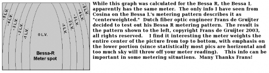

2. Is the metering centre weighted or bottom centre weighted?

I have an R2 as well. The 90 frame marks are good but take a bit getting used to. The meter is center weighted. I have not had a problem with battery drain and I keep mine with the shutter cocked.

Bingo! Frans de Gruijter is the man from whom I got adapters which turned the 1.55V of silver oxide cells into the 1.35V of mercury cells. I knew I had seen his name somewhere in connection with the CV Bessa's metering pattern. Well, here it is, on the Bessa L page of the Cameraquest web site. Much the same thing is repeated on the Bessa R page.

I understand the meter on my Bessas takes a reflected reading from the grey surface of the shutter, though the spec sheet says it's TTL, Centre Weighted, Averaged. So I don't see it as really being "centre weighted". Just a reflected reading of the light coming through the lens off what is essentially a grey card.

If the CV Bessa can use LR44 (alkaline) cells, Leigh, I am a happy man: because those are freely available in India. Not so with SR44 cells. The reference to mercury cells had nothing to do with Bessas. I needed the adapters when I still had my 1970s SLRs, which were designed to take mercury cells. The diagram shows which parts of the grey shutter reflect how much light on to the sensitive cell. I'd call it middle bottom weighted.
Yep. Understand. I don't think it will make a pinch of curry powder's difference in actual use. I've found the Bessa meter to be pretty accurate - more accurate than when I try to outguess it! I mostly use the AE facility.
In most use, all metering patterns give pretty much the same result: but it could make a whole Tandoori Wallaby worth of difference if there's a light coloured subject off centre against a dark background.
