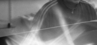

Well it looks like I've hit another damn obstacle.
The first camera - Zeiss - was fine....the second camera - Ernemann - looks like it has light leaks!
Of course the bellows felt rigid and degraded when I first looked at them, but the working shutter and solid body had me hoping!
The bottom of each 6x9 frame (so the top of the camera if we reverse everything) shows spikey lines, almost cross-hatched.
From that description, is there a chance it's simply a loose join to the body? or is there a chance the WHOLE bellows will need replacing?
the bellows look tired and worn anyway, and I would like to use it for taking photo's so I've no problem getting new bellows, but is there a site on the internet which can provide small-scale (medium format folding camera) bellows?
I'll have a scan in an hour or two once the film dries and I can get on the pc with scanner.

Here's a crop of the light leak at its most distinct (the other photo's are the same but vary from a whole chunk of white, or a tiny blur)
Using a torch I only found a single pinhole. Does one tiny pinhole really cause this much damage!? :eek:

Pinholes are easier to find using a small flash unit poked into the open back of the camera. Cover the gap with something (a black t-shirt) and dim the room lights. No closet needed. Be sure to check the bellows where it joins the camera and lens plate. Most folders need to have focus adjustments. Scroll down this page for an idea of one way to do it: http://www.davidrichert.com/AGFA rebuild/agfa.htm. Rick Olesen also has some techniques on his repair site.

So, don't panic. Gaffers tape works wonders. You may even need to apply some cloth media paint on the inside corners of some of the folds.
You definitely need use a small photo flash poked into towards the back of the bellows to find all of the light leaks.
For the best light show, sit down in a darkened closet. Check all four edges of the bellows and where the bellows connects to the camera.
Thanks for the help everyone. I'll see what I can do about the pinholes, but on searching around I could only see the one on the back corner, about one or two folds out, which may be why it disperses like in the picture.
Noel, outer dimensions of the lenses are about 28mm and 27mm I think. The calipers have gone walkies (as usual) so that may not be totally correct measurements!! Thanks ;)
A cheap way to patch corner leaks is black cloth masking tape. I found a roll at an art supply store. It was relatively cheap and is labelled "CT34BLK" on the inside.

In the US Home Depot we have a product called Liquid Electrical Tape which works quite well on bellows. I painted it on the inside and left the bellows extended to dry.
Ash,
I use the reverse method to check bellows, in a bright room open the camera and hold to your eye at the film gate. The pinholes stand out clearly. This easy to do when buying a camera so you know what your up against. I too have used liquid electrical tape inside the bellows. Mix well before use. I found it at an auto parts store.
