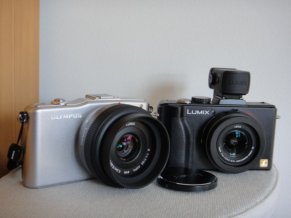

As you can see below, the E-PM1 with Lumix 20/1.7 is just slightly larger than the Lumix LX5. At only $449 (with a kit zoom and flash which I will probably never use) I thought it was worth a 'shot.'
So far I am very impressed. Very pocketable. Fast focus. Unobtrusive on the street. And image quality is really excellent (the second shot is with the Oly 45/1.8 shooting into the light at f3.5, straight out of Lightroom).

The LCD in bright sunlight is only average for the genre. Usable, but difficult when there is direct sunlight from behind.
Kirk
Kirk,
Your review echoes my impression when I held an E-PM1.
The thing redefines the meaning of "sleek"
Although I do think that Olympus should have just two models the E-P* and the E-PM* and be done with the E-PL* line and use the design resources to improve the E-P* line (adding a built in EVF, for example :) )
'Sleek' is the right word. Oly produces some very good bodies / lenses, but seems to have no strategy. Hope they survive the current turmoil and produce some great new stuff.
