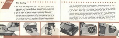

i'm having trouble finding a manual for the Olympus Pen, 28mm/3.5 D.Zuiko. Thought I had loaded the film, but it never went anywhere apparently....

Will try to attach a page from the manual about loading film.
When lens is turned counter-clockwise all the way past 2 the focus is set at 12 inches.
Thanks Delible! It's great to have the 12 inch focus!
Since posting I've successfully loaded 1.5 roll. I didn't finish the first roll, because I wanted to get the C41 film to develop for a quick look. Well, I love the lens! But, there were some that didn't quite take. I got a lot more blank frames than I thought I took.
