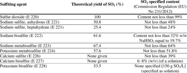

That is just a measure of the purity of the sulfite.
221 is supposed to be good purity Sulfite (90%+)
The equivalent yield of SO2 is used as a way to measure purity and is used in specs and in the European deifnitions
49% SO2 is about 96-99% Sulfite and thus perfectly usable
Check this spec for instance
From
Scientific Opinion on the re-evaluation of sulfur dioxide (E 220), sodium sulfite (E 221), sodium bisulfite (E 222), sodium metabisulfite (E 223), potassium metabisulfite (E 224), calcium sulfite (E 226), calcium bisulfite (E 227) and potassium bisulfite (E 228) as food additives

  • Theoretical-sulfur-dioxide-yield-Ough-and-Were-2005-and-specified-content-according_W640.jpg
Thank you, Titrisol - I was looking that as a (currently somewhat brain dead) biochemist and wondering why it hadn't horribly gassed the OPer!
This is absolutely correct. This is a food grade product and this is the product spec.
