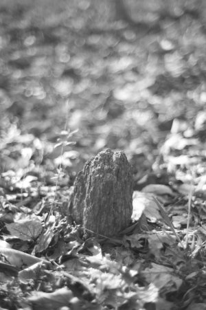

BTW this is probably the most 'film-like' shot I've taken with the Monochrom (the original one), ISO 320. The print is easily mistaken as a darkroom print:
Untitled
by Vince Lupo, on Flickr
