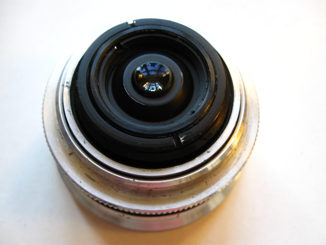

I have an Orion-15 right in front of me which works perfect. It seems you either got a wrong rear element that was stuck instead of the original one or it is not correctly assembled. At least my Orion-15 looks different from the rear. I will post a macro later.

Here is the pic of the Orion-15 rear element. It should have the same construction as yours, although my Orion was made in 1965 (but in the same ZOMZ optical plant). Sorry, a quality of this snapshot is not top notch, anyway you may see what the heck is it.

I've an Orion 15 and the rear element looks like the one shown by xoDox not yours. I'd send it back for refund if it wasn't as shown and described.

xoDox - yes that is quite clearly not the right rear element on my lens. Funny thing is that the front element looks a bit weird too. Damn - always test shoot the gear as soon as it is unpacked...
