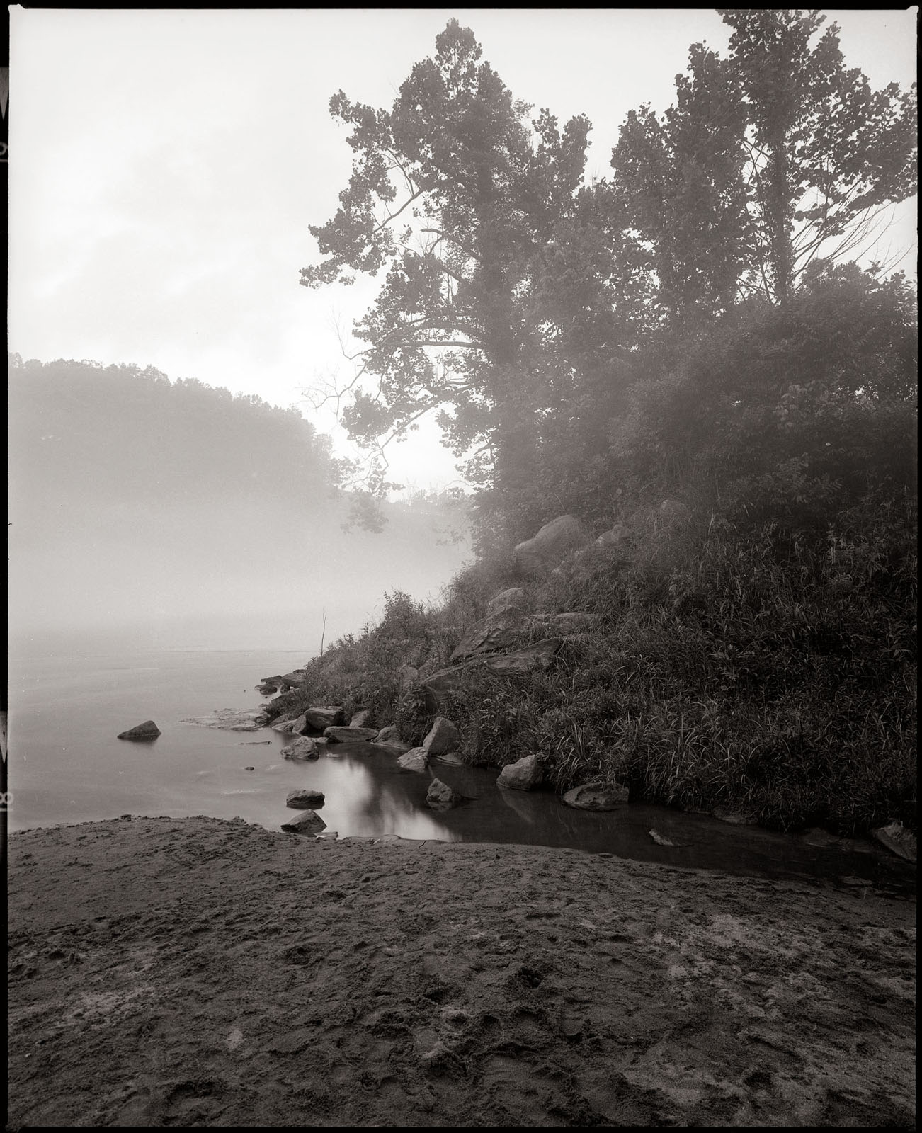

Pan F+ rated a bit lower than 50 and Rodinal 1:100 semi-stand for an hour is an amazing combo, give it a try! Talk is cheap, here's an example:
This was a 6x7 negative from my 2x3 Graphic and I think my 47mm XL or maybe it was my 58mm XL.

It looks nice in here. I had stopped doing stand development as I had no control over the contrast. This one looks like it eases quite a lot the harsh contrast of Pan F. I will do a test with a 12 frame roll.
I haven't found it to be an issue. Just another tool in the toolbox. Contrast control, in my opinion, is for sheet film. Semi-stand is just very forgiving in my experience. I haven't been using it as much though, as I've been having some strange results with Rodinal (Adonal) depending on the age and oxidation of the solution. I'm "aging" my new bottle of Adonal right now...
