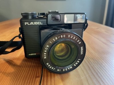

I purchased a Plaubel Makina 67 from a Japanese seller in November of last year. When it arrived, although it looked great cosmetically and everything else seemed to be in spec, the viewfinder had a dark occlusion covering two thirds of it. I wrote the seller, after talking to my usual camera repair guys, and the seller refunded me the cost of a service; I sent the camera in for service and repair.
With the holidays and the usual hubbub of camera repair shops, I received a note from the shop on Friday. The issue with the viewfinder is that the RF prism has become uncemented and damaged, it needs a new one, and they have no supplier who can get one for them. Ugh. I wrote back to the seller and explained what the situation is, and the seller is going through the motions to get me a refund and have me ship the camera back to him, on his dime. So that's in process...
Well, I'd already sent queries to a few other shops. And a vendor on EBay named "wizcam" has asserted that he can repair the camera.. The price would be 1/3 again what I paid for it...
So I debate with myself ... Do I risk sending it off to him, which will nix the notion of a refund with the Japanese seller, or should I just be happy with the refund and let it lie as a sad moment, move on? Of course, I do not need another camera (LOL!), the heavens know I have way more cameras than I can ever put to serious use at this point. But I was always curious about a Makina 67 ... It's a pleasant oddball that appeals to me. 😉

In this case, the issue is that the beam splitter inside the view/rangefinder assembly has come apart and my usual shop had no access through their suppliers for that part, new or used. F. Binder, being a Plaubel Makina specialist, has a parts stock on hand and/or several donor cameras from which to swap out a usable part. In the extreme case, someone could repair or make a new beam splitter/prism assembly, but that's really a job for a heavy duty specialist as it has to be very precisely made, not generally a job you can do without very precise optical equipment.

The Makina 67 has arrived back from service today.
In addition to the occluded viewfinder issue (due to a prism assembly coming apart), I'd reported that the meter seemed to be acting oddly and asked wizcam to please check it and everything else. It turned out to need a new meter board if I wanted a working meter, so I approved that as well as the viewfinder repairs. Of course this raised the repair price a bit, but eh? I'd rather have the camera in proper working order.
Wizcam (F. Binder) did an excellent job as far as I can tell. The camera looks and feels in use as if new. I've loaded a roll of film for testing, but I honestly don't expect any issues. The Makina 67 is a camera that I've been curious about and wanted to try since the late 1970s when it came out, and I'm very happy to have a nice example at my disposal to use now.
