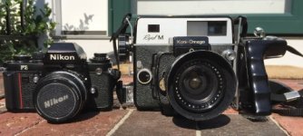

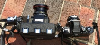

thanks for the comments so far! I especially appreciate the links. Seems like nobody here currently uses one? Could someone measure and weight their Koni please? I'd like to have a better idea of the actual dimensions.
sleepyhead, the Horseman doesn't have a coupled rf and coupled film a advance/shutter cocking, does it?
I picked up a Rapid M a couple of weeks ago with the 60mm. I haven't put film through it yet. I need to make new light seals for the film back and maybe the carrier insert. It is an odd camera but once you figure it out it makes sense.
My plan is actually to convert it to a 35mm panoramic camera. The feed should be OK and the pressure plate is awesome in that it moves back to advance the film and then presses forward to take the shot. I need to trim to pressure plate slightly (maybe a mm or two on each side) so that 35mm cartridges will fit and hopefully feed properly. I am going to feed from one into another to avoid having to worry about rewinding.
On the Rapid M and 200 models the film carrier also comes out (not just the film back). That should make it easier to add a 35mm mask into the camera as you can get at that easily with the carrier out. It would also allow one to switch between panoramic 35mm and 120 easily.
My bathroom scale said 4.6 pounds for the Rapid M with the 60mm, a back in it but not having the 60mm finder on it. The finder is pretty close to the actual viewfinder size so it may not really be needed.
Shawn
