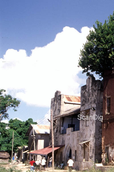

CoolscanIK13 said:I mean software aside, how does it compare to the "king" Coolscan for example (with a REAL max resolution of 4000dpi and DMax around 4 if I'm not mistaken).
Plustek
Source: http://www.filmscanner.info/PlustekOpticFilm7200.html
Effective dpi is rated 2900.

Thanks Prosaic for posting the comparison scans of the Nikon vs the Plustek (sounds like some sort of dental tool or something). I was hoping to use one of these for B&W negs, but the sample here clearly shows loss of detail. Look at the cloud. It has lost all of it's tones. I doubt it would be recoverable in levels in PS either. Makes no sense to use great lenses and great film only to lose so much of the native neg information due to your scanner. A new Nikon is only around $550, and used ones can be got for $400 and up, so the minimal amount of savings in money doesn't seem to be worth it. In this case you seem to get what you pay for. The one caveat I have w/ the comparison scans is that I wonder if the contrast hasn't been set too high in the Plustek, or if the lack of tonal range is due to the poorer Dmax rating compared to the Nikon. I also wonder if you could turn the contrast down in the software and get a more detailed scan. In the end, I may buy one after all and tweak it to see how it compares to my previous Coolscan scans in B&W. If it fails, it goes on ebay and I haven't spent too much.

myoptic3 said:I was hoping to use one of these for B&W negs, but the sample here clearly shows loss of detail. Look at the cloud. It has lost all of it's tones. I doubt it would be recoverable in levels in PS either. Makes no sense to use great lenses and great film only to lose so much of the native neg information due to your scanner.
OK I should probably have left this at my last post, but IMO the comparison in the German review is just pure s**t. The guy obviously had an agenda, or maybe a hard-on for the Nikon. Or perhaps - he just had a single bad example of the Plustek to work with.
Whatever - so far as I can tell the clouds in the Plustek image in that review simply indicate a bad job of tweaking scan settings - not any inherent limitation of the scanner itself. Look in the other reviews or in any of the Plustek scans that have been posted to this site and you will see that the loss of detail in the cloud in that one picture is anomalous - to put it in the best light (no pun intended) - not to say just amateurish.
The reviewer suggests that the lower Dmax of the Plustek is to blame for the loss of detail in the clouds. This is just not the case. AFAIK lower Dmax leads to loss of shadow detail in the darkest areas - not the lightest.
