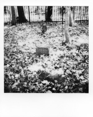

Polaroid made B&W film for the 600 series "back in the day", I used to shoot a lot of it 1999~2004 (I just found the box of Polaroids, stored in the box for an i960 dev kit) until they quit. I've also used the new B&W film, made a filter holder for it to use Kodak Wratten type filters. I used the holder for the Sunshade. The new film seems to have less latitude, and a different spectral response than the original of 20+ years ago. I placed a small strip of the Wratten filter over the Electric Eye for compensation.
Next time I try some- will use a Green filter for skin tones.
This- experimenting with new film, was with a Magenta filter:
