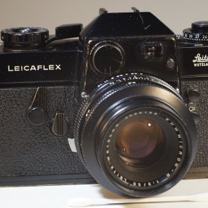

I enjoy using the Leicaflex, I have five of them. SL MOT, chrome Standard, chrome SL, black paint SL and a chrome/black SL. Two of the bodies were CLAed by DAG. Here is a photo of the bodies:

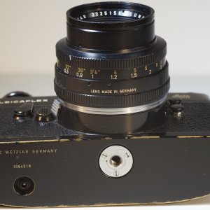

Here is one of the first 20 black paint Leicaflexs' made, in original found condition with later lens.
