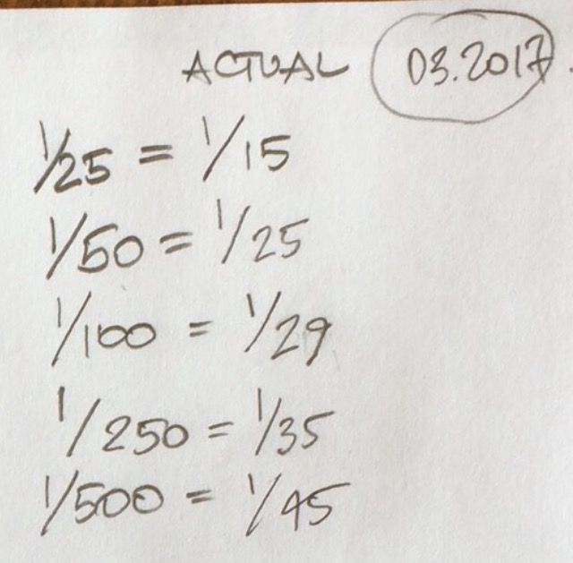

This is what I get.
This is too much off, but meanwhile you said the camera is nice and smooth... So I wonder if there is something wrong(lacking parts) with the shutter speed mechanism( the pin-in-hole arrangement as mentioned above), rather than just bad tensioning of the curtains.
How reliable are the test result? I mean if the 1/500s behaves like 1/45s, you should be able to tell it from bare-eye observation.

Checked my other camera and it's right on.

I'm trying to visualize how that combination is even possible. The only thing I can think of is a film chip or something stuck in the gears of the #2 curtain, causing it to hesitate 1/50 second and then pass through. Do you happen to have a CRT television set around anywhere? Those are great for giving you a really good look at what the shutter is doing.

No, I was using one of these
http://www.ebay.com/itm/162299432217?_trksid=p2057872.m2749.l2649&ssPageName=STRK:MEBIDX:IT
The problem, of course, is that with Zorki 1 you cannot put it on a back of camera for direct light access like you would do with M6 for example.
So what I did was- I inserted the piece of aluminum foil in place of film and tester was positioned on front of a camera (replacing the lens). I also was shining the light into camera with small flashlight. So shutter would open the curtains and light shining thru would reflect to the tester. It was very repeatable, I tried at least 3 times for each measurement (I am engineer by profession :) )
I would try removing the body shell so that you can sight properly through the shutter, and repeat your speed tests. You might get the same results, but it's worth finding out. I've heard of that profession .... as I recall, using instruments in the way they were designed to be used was one of the rules.

You're an engineer and I'm not, but how exactly does the gizmo you are using measure the width of the slit that will determine the exposure of the film?
When you checked your other camera and it was right on, did you use this same method, with aluminum foil in the film gate and aiming the tester in the lens mount? Or with that camera were you sighting through the shutter curtains per normal practice? If you're comparing one to the other to verify your test method, you need to be using the same test method.
No, I was using normal method, because with my other cameras I have access to the back of a camera.
I agree this is not necessarily apples-to-apples but close enough. I mean, if it's accurate enough for slow speeds, then it's equally accurate for faster speeds. Slow speeds are one step off, where the fast ones are completely out...

I would not assume the apples-to-oranges is close enough until I'd proven this to be the case. Given that you have access to the lens mount of your other camera it should be easy to test both cameras that way; and you can compare the results between the front- and rear- positioned tests to confirm that the front-positioned test is accurate.

It would not be difficult, indeed.
My point is: if I am wrong with fast speeds, then I would be proportionally wrong with slow speeds as well.
