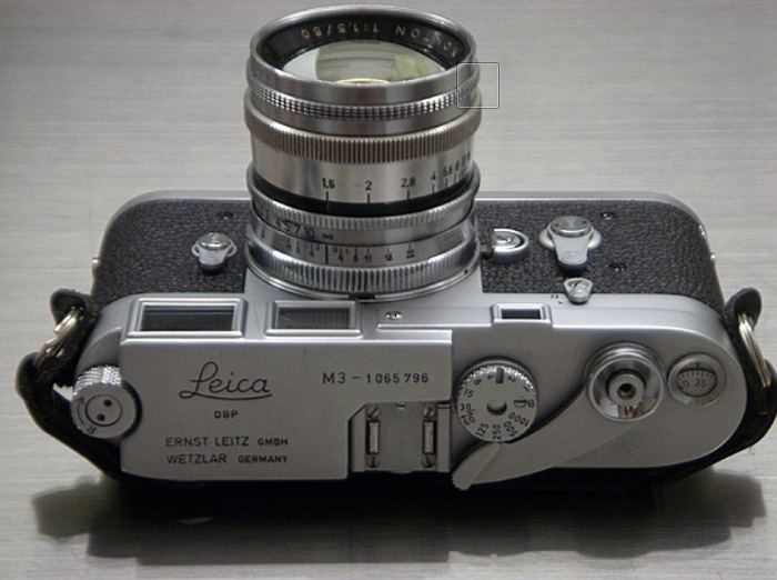

Hi, I just bumped on this picture while I'm searching for Leica adapter to use my Prominent Nokton adpater. Anyone can recognize this type of adapter? It looks different from MS-optics and any other adapters of these days.
Thanks in advance.
Amedeo makes an Prominent adapter to Contax S. Then, I use an adapter for Contact S to Leica M.
I am not sure that it is like what is shown in your image.
I have an adapter which I don't remember where it came from which allows me to use the original (Prominent) Nokton on my Contax IIA. I also have an Amedeo adapter which allows Contax RF mount lenses to be mounted on Leica M mount, so the Nokton can be mounted to my Bessa 2 and also to my dearly departed and once owned, M3 and M4-P.
Makes due in comparison to the rare & $$$ LTM Nokton of which I'll never own.
This adapter is available from a few days ago, will let you use 50mm Prominent lenses as Nokton or Ultron to Leica M mount bodies. Still must refine the design, but users report that work well with their lenses.
Amedeo Muscelli
One desirable feature not often seen in such prominent-ltm/M adapter is to allow a non-rotating travel during focusing (lens not rotating). This enables the original 310/47 or 310/49 semi-rectangular hood to be used.
I can confirm that the Kipon prominent-ltm adapter sold on various sites does not allow non-rotating travel. However, the Kipon adapter allows RF coupling to be adjusted.
FWIW, I have purchased Amedeo’s adapter to mount Prominent Nokton on Contax. I have to say, focus is spot on mounted on Contax and on Leica M3, using Amedeo’s Contax to M adapter. Thank you, Amedeo, for making great products of wonderful quality. Bravo!
Amedeo Muscelli
Looks great! Where I can buy it from? I can't see your adapters on Evil bay.
