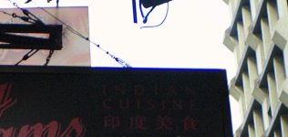

Here are five examples of issues I've found in some of my shots- read many many images. If a picture is worth a thousand words here's five thousand words to make my point. Now if more then just a weak range finder is the issue I'll post my results when I get a new camera from Robert White (mine is still under warrantee and under one month old).
This sample set shows the artifacts of sensor/filter flare caused by the thick IR filter in front of the R-D1s digital sensor. On the bridge shot see the blue fringing near the top of the bridge. On the street sign shots see the blue fringing along the top bars in the exploded view. On the light bulbs you'd have to be blind not to notice : )

Every RF from every maker has the potential to go out of alignment, but I doubt very much the Epson is more pronounced in this respect than anything else. The main issue to date has been new cameras being shipped with the RF out of alignment, not the RF easily falling out of alignment once it is correctly set.
As for your images. The blue fringing on the first two images is quite unlike anything I have ever seen from my camera, I have had no fringing effects like this at all. Maybe try a different lens, it may not be down to the camera. I don't know how you can assume it's a product of the IR filter. The third image probably needs to be underexposed by a third of a stop or so and then gently fixed in raw processing (this would be a tricky image for any camera, film or digital, and the Epson meter does need experience, it's taken me a while to get a consistent sense of when it is likely to go wrong). The flare around the fluorescent lights in the last 2 images seems to me to be unsurprising, a very common artefact with many cameras. Since I rarely shoot fluorescent lights in the frame it would not be an issue for me.

Sailor Ted
Ian,
Three different lenses were used in these photos:
12mm CV
21mm Zeiss
35mm Summicron (Leica)
According to Rex (WOOF!) here at RFf the fringing in the first photo (signs) is due to the thick filter Epson placed in front of their digital sensor and is the reason Leica did not place a thick filter in front of theirs. As to the third shot I bracketed it and have another shot that is exposed as you suggest- I'll have a look and post the result. As to the light bulb this too is due to the thick filter in front of the digital sensor and is also the reason Leica choose not to place a thick filter in front of their digital sensor. I for one am glad of Leica's decision.
12mm CV
21mm Zeiss

iml
How does Rex know this for sure? As I say, in 4 months I've never had any such fringing issues. I think you're jumping to conclusions a bit. If an IR filter in front of the sensor *caused* this sort of fringing, I would expect Leica to have removed the filter completely from the M8, and other manufacturers of high quality digital cameras to do the same. And I would expect to see signs of this fringing in my digital images, all of which are taken with cameras which do have an IR filter in front of the sensor.
The blue fringing in your first two examples doesn't look to me to be the same artefact as the haloing around the fluorescent lights in the last two, or the exposure issue in the middle one. It could easily be down to the lens used in that shot, or something entirely different.
I wouldn't get too excited about Leica's fix for the M8 either. They may be recommending IR filters in front of the lens for the M8, but I'm willing to bet good money that if they ever make another digital M it won't have the same requirement, it'll be filtered at the sensor.

Sailor Ted
Ian,
The ghosting and flare has something to do with how close the lens gets to the sensor in a DRF and the acute angle of the light passing through the filter before reaching the sensor. This is why you won't find this issue on a 5D or DSLR. It's very much a DRF thing and was part of what Leica was talking about when they stated a DRF was not possible given the current state of technology. With the introduction of the R-D1 not to mention the markets overwhelming shift to digital Leica's hand was forced with the M8. That said I feel they made the best set of choices in regard to image quality they could given the current state of technology. As to my (and your) Epson? They are fine cameras but this artifact is not by any means a rare occurrence. It's well understood by engineers who have and are working to develop DRF technology.

iml said:I have never experienced anything like the blue fringing in your example. In addition, halo around fluorescent lights is not the same artefact as blue fringing, and a scene with mixed exposure requirements is a different issue again. Ergo, your one-size-fits-all explanation is unlikely to be the cause of the problem here.

This is caused due to the extreme backlit nature of the shot and is a result of the thick filter in front of the digital sensor. I have seen it in only a few images out of going on 1400+ images now but then again I have taken very few such images.

Sailor Ted said:This is caused due to the extreme backlit nature of the shot and is a result of the thick filter in front of the digital sensor.
