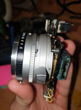

The big issue has been the focus ring. At first it was completely stuck, as in no movement whatsoever. Tried heating it, tried lighter fluid. Seemed to be loosening, then suddenly it snapped and jumped about 1cm, but the lens didn't move at all. So now its at about .8m focus (by testing in viewfinder), but can be set up to about 1.5m although the lens doesn't actually move so its still actually focused to .8m.

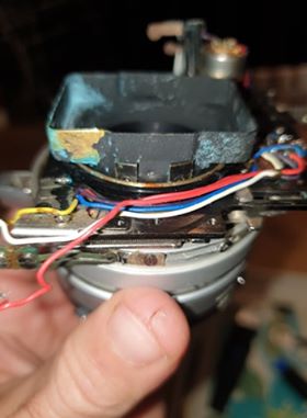

Am at the point now with the lens (still on the plate) removed from the body. I can't remove the rectangle hood from the back of the lens though because the screws seem to be blocked, I'm assuming because its stuck and the lens can't move in or out.
I need to get a spanner tool to continue, but am I right in thinking the focus helicoil is stuck? I'm learning as I go here, so not really sure. Also I'm aware I likely broke something in the focus ring..hoping I can just spot that and fix it at some point
Again, appreciate any help. Photo attached to show distance lens is stuck at and "buried" screws on rectangle hood. Lots of cleaning to do too..
