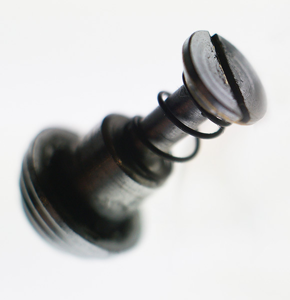

With some lenses there is a slot that allows you to unscrew the pin which holds the lock mechanism together. Don't let the spring escape and you can refit it later if you wish. I've done this with Canon 50/1.4 and 50/1.8 LTM lenses and can see this slotted screw on some FSU lenses like the I-22.
This is the screw...
Thank you for this and the image.
In the past, when I have removed an infinity lock, I put the parts in an empty film can, label it and save it carefully in case I want to restore the infinity lock at a later date. Joe
The infinity lock on the Canon Serenar 50mm f1.8 is held on by a slotted screw as in the picture above. The infinity lock on the Leica 50mm f2.0 Summicron collasible is held on by a screw with two small dimples that requires a pointed-tip spanner. Remember these screws have been in place for years and can be hard to remove.
