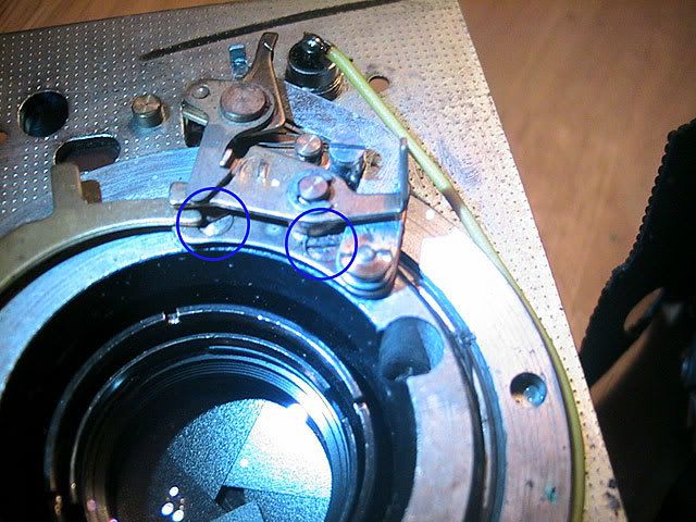

Make a note of what ISO your camera is set on. Unscrew the front lens element (you'll need a friction wrench). Under it, you will see a wavy nut, secured in place by a locking screw. The locking screw has one flat edge. Turn it so the one flat edge is toward the wavy nut -- this unlocks the wavy nut and you can unscrew it. Unscrew the wavy nut.
Okay, pay attention to in what order the rings are stacked up on your camera and just lift off all but the bottom ring (the one with the shutter speeds and all the slots in the front of it). The bottom ring is the shutter speed cam. Look at the two small pins that are engaging the slots. Make a note of where they engage the slots. Now remove it.
Take a small artist's watercolor brush and squirt a few drops of lighter fluid on the gears. Work the brush back into the gears and scrub at them gently. Don't disloge any springs. Cock and fire the shutter a couple of times. Squirt a few more drops of lighter fluid in there and scrub it some more. Fire the shutter a few more times and then rinse out the gears with more lighter fluid.
That takes care of the gears. If you put the camera back together at this point, and if your shutter blades were clean, you'd have your shutter speeds back, but you're not done quite yet.
Get out a box of cotton swabs. Wet one end with lighter fluid (really wet) and gently rub at the shutter blades. Fire the blades a couple of times. Turn the swab around and rub gently at the blades with the dry end. Throw the swab away. Repeat about 50 times. This cleans the shutter blades. If you reassembled the camera at this point, your shutter times would be as accurate as they are ever going to be, but you still have the aperture to do.
Put the cam speed dial back on the front of the shutter, engaging those two pins back in their slots. Holding it in place, rotate it to the B shutter speed. Fire the shutter and hold the button down. You will see the aperture blades. Wet another swab and do with them what you did with the shutter blades: Wet them down with lighter fluid on the wet end of the swab, work them a few times, then mop the dirty fluid up with the dry end of the swab. Repeat this about 50 times.

I also have a Konica Auto S2 (well, I have two but one has the aperture and shutter blades floating freely between the lenses) and could use some advice.
It's in almost mint condition, but the lens is slightly wobbly. The wobble is at the base of the lens where it connects to the body. Searching around, and after testing the four srcews that hold the lens plate against the body and finding them tight, I think the problem is similar to the one outlined here (the pic is taken from that post)
I'd like to remove the lens and test those three screws, but being a total newbie at this I have no idea how to remove the film advance lever and rewind knob from the top plate. And while I'm at it, are there any hidden screws, or anything I should be particularly careful about when removing the top and bottom?
Edit: I managed to remove the top, bottom, and unscrew the lens assembly. Checked those screws, and they were super tight. I might dismount the whole lens and shutter and check if there's anything else that needs tightening, or trust the camera repair pro who had a quick look at my S2 and said the wobble is due to wear in the helicals and there's nothing to do about it short of packing them with grease, and the optical performance should be unaffected.
