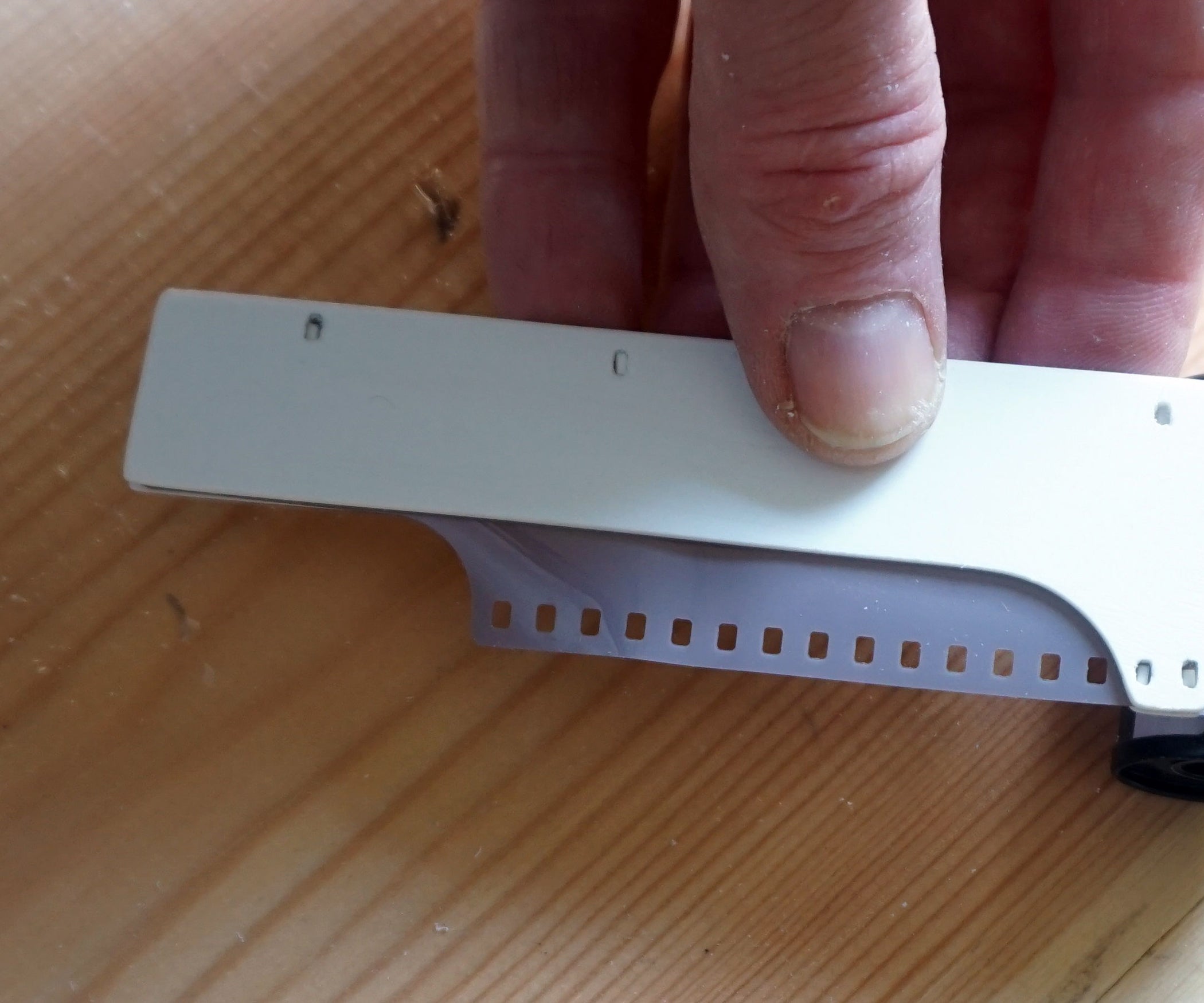

As I always carry a Swiss Army Knife, I have, and do, use scissors as admirably detailed above. However, when preparing at home I use a 3d printed Ablon clone:
There are others but this one has four sprocket hones to align and works well with a sharp scalpel. However, I’d only bother if you have access to a 3d printer (i.e. don’t pay a service, it’s not worth it). Also beware when threading wire though the hinge as although they are tough when assembled it is easy to break when putting them together.
