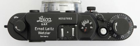

It's actually quite an old-fashioned finish/colour scheme. Here are a couple more detail shots:

That's dashing looking -- very stealth. Sure was a homely camera with zits and a ghastly flash sync hole before. Looks like a superb paint job.
You've left almost no chrome, that's no "Panda" camera. The paint may wear really fast on the knobs.
I'll give a report on paint wear when I've used the thing for a bit – it only arrived in the post last week. CR&R tell me the finish is done to a British Ministry of Defence specification and is 'very hard wearing'. They can also do grey and olive green, to order.
Ask them if putting a coat of wax or matte clear coating would be a good idea. Anything you can do to protect the finish would be wise.
Including the cost of service and parts – including a pair of shutter curtains, release button and body lugs – the whole thing finished up just south of £400/$640. CR&R discounted cost of chrome strip and refinishing (normally £350/$560) because much of the strip-down and rebuild effort was duplicated in the service. I think this was especially generous, as they had to turn up and braise in place a plug to fill the flash sync hole – and it can have been no easy task to make this an invisible repair.
