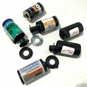

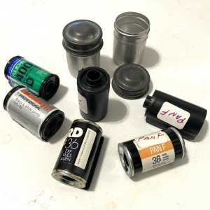

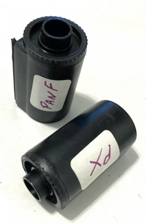

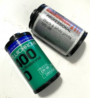

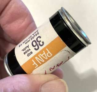

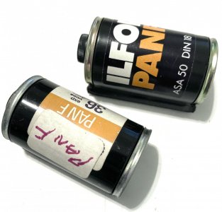

Here are some of the old cassettes from the 60’s. It appears Ilford continued to use the old design well into the 70’s and possibly later. Fuji also used a reusable cassette until somewhere around the late 80’s or early 90’s. I might be wrong about the dates though.
Notice the metal cans Kodak used. Agfa used a metal one without a threaded cap. I may have one somewhere I can show.
