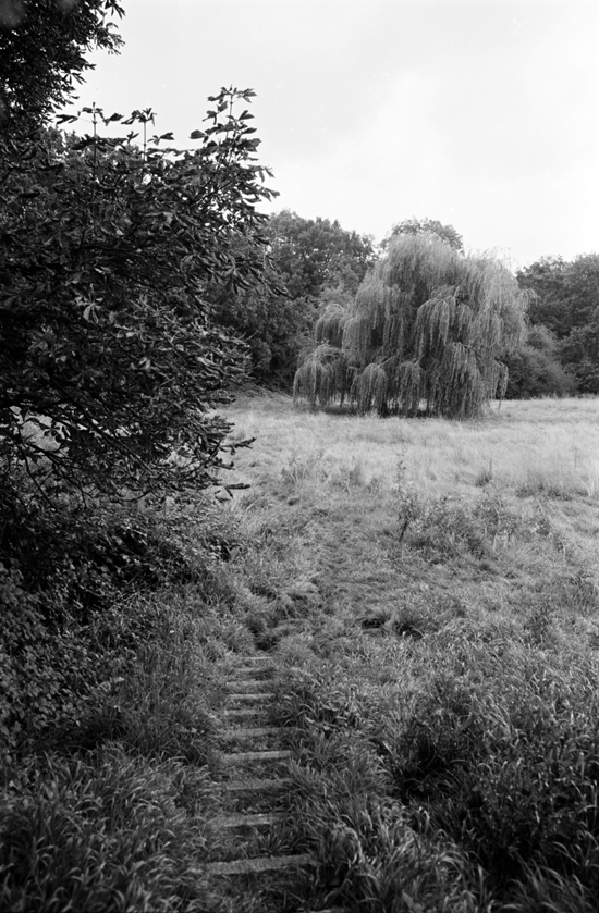

Currently going through a roll of Tech Pan and plan to develop in Rodinal 1+150 (rating film at EI 16). It's the first time I've tried Tech Pan and from what I've read this should work OK.

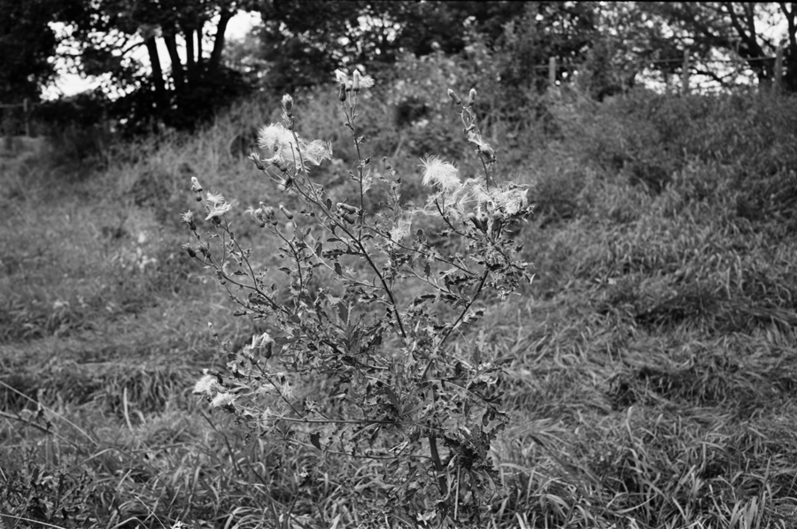

Technical Pan in Rodinal 1+150
Developed last night and I'm pleased with the results.
