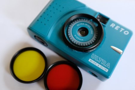

I also find the look of the Reto- pics quite interesting. I glued a filter adaptor around the lens, so I can use the little cam with a ISO 400 film from shadow to bright sunshine. Soooo light and easy in the bag...!
Brilliant, @Harry the K! I'd seen similar modifications, but the others seemed to obstruct the viewfinder. What size filter adapter did you use? I used 400 speed B&W film in my test roll, and some frames came out overexposed. Bright sun up in the mountains was probably not the best conditions for Arista Premium 400 (aka Kodak Tri-X?) and yellow or red filter would definitely have helped.
The adapter is 39 to 37 mm. The glueside is the 37, so I can use my 39mm filters from the Summicrons, reversed. However, I had to make a little cutout on the adapter due to the elevated frame around the vf- window. But the adapter is 99,8% invisible in the vf.
Thank you, @Harry the K! I did notice a little notch cut out in your adapter. Good to know there's not too much blockage, though I'm not sure how accurate the viewfinder is anyway.
